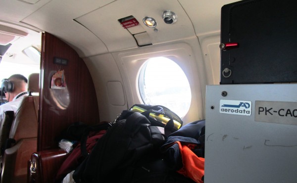

I am definitely in favour of the pictogram.
EXIT, even with possible translation in a second language doesn't stand the comparison when you want to communicate universally.
I took this pic during a calibration flight earlier this year and the addition of the Bahasa Indonesia wording does not make it any clearer that this is supposed to be an exit way.
Re: EXIT signs on aircraft
Doesn't seem like an exit, looking at the pile of luggage in front of itHomo Aeroportus wrote: ↑05 Jul 2017, 21:46 I am definitely in favour of the pictogram.
Hey mate what do u showing us, exit or that beauty ? )) too bad i'm injured now.. really miss the planes... instead i must stay at home ... good things there are these forums where i can forget a bit about problems.quixoticguide wrote: ↑19 Jun 2017, 14:35
interesting topic: the Air Koryo IL-18 has a Red Exit sign.
Reason: removed advertisement
- Posts: 1498
I had the same reaction, hence the photo, but we were only four on board (Beech King Air 200) and I had no real safety concern. Just a bit out of ordinary.luchtzak wrote: ↑05 Jul 2017, 22:24Doesn't seem like an exit, looking at the pile of luggage in front of itHomo Aeroportus wrote: ↑05 Jul 2017, 21:46 I am definitely in favour of the pictogram.
As was the hundred times repeated aural warning "Too Low, Gear ; Too Low, Gear ; ..." but OK no worries. Real good pilots from DGCA with all the fun of an afternoon flight at low level and near the equator

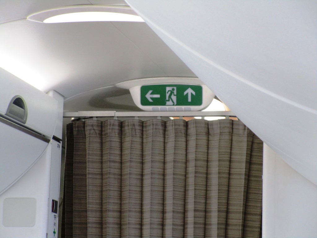

BCS1, HB-JBB, BRU-ZRH last year.
Behind this curtain you have access to door 1L on your left, and ...
So I asked the "Maitre de Cabine" if the cockpit was an intended escape route.
She answered "Ja, I have also noticed zis and made a report. I don't sink zis is normal".
hahaha Quite ambigious indeedHomo Aeroportus wrote: ↑30 Apr 2018, 11:29 So I asked the "Maitre de Cabine" if the cockpit was an intended escape route.
